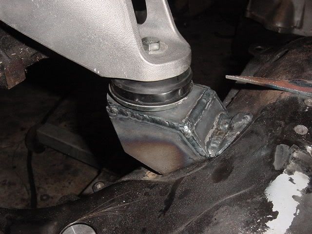

I sent the final drawings to the CNC cutter this weekend and will be able to begin filling orders on 6/11.
Here are the latest pictures I have of them.  The design has had minor changes since these were taken, but you get the idea.
The main advantage of these motor mount adapters is the ease of engine installation and removal.  The placement is similar to Granny's rear holes or Hinson's kit.  Transmission shifter comes up in the correct location with no Steeda or like shifter handle needed.
I currently do not offer a tranny support, but one will begin development soon.  The mount will be designed so exhaust can be routed under it, not above it like everyone else's mount.  If your project will drag out that long, I suggest to wait, but if not, Granny's or Hinson's tranny mount will work with these motor mount adapters.
I will be including the rubber biscuits engine cushions for those who haven't bought theirs yet for $32, no additional shipping.  The cheepest I've seen these is on Ebay for $27 + 6 shipped, so my pricing is definately competitive and will save you the time of another order for your project.
Price will be $165 shipped for the mounts, metric hardward included (all the other kits use standard hardware ???)
Mounts plus engine cushions $197 shipped.
Please write something like "FC C5 kit" in the Paypal notes.
All you'll need to get your engine mounted is some C5 or C6 engine pedistols.  GTO MOUNTS LOOK SIMILAR BUT WILL NOT FIT.  I've had pretty good luck putting WTB ads up on LS1tech to find those.  Here are some pics of test fits.

A couple questions about the mounts,
Are there any images which show how the mounts attach to the front crossmember? I'm assuming nut and bolt (especially since people have mentioned using the same holes as the granny's kit), though I've yet to find an image which shows it explicitly.
Also, has anyone who has received the pre-lim kits been able to test fit headers. The immediate thought is it looks like there is oodles more room with the pedistol mounts for headers, though sharing of first hand experience would be sweet!
In any case, these look just plain awesome. Good job to all who had a hand in it!

here some pic of the rubber mount
