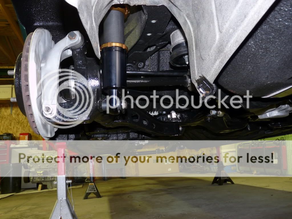

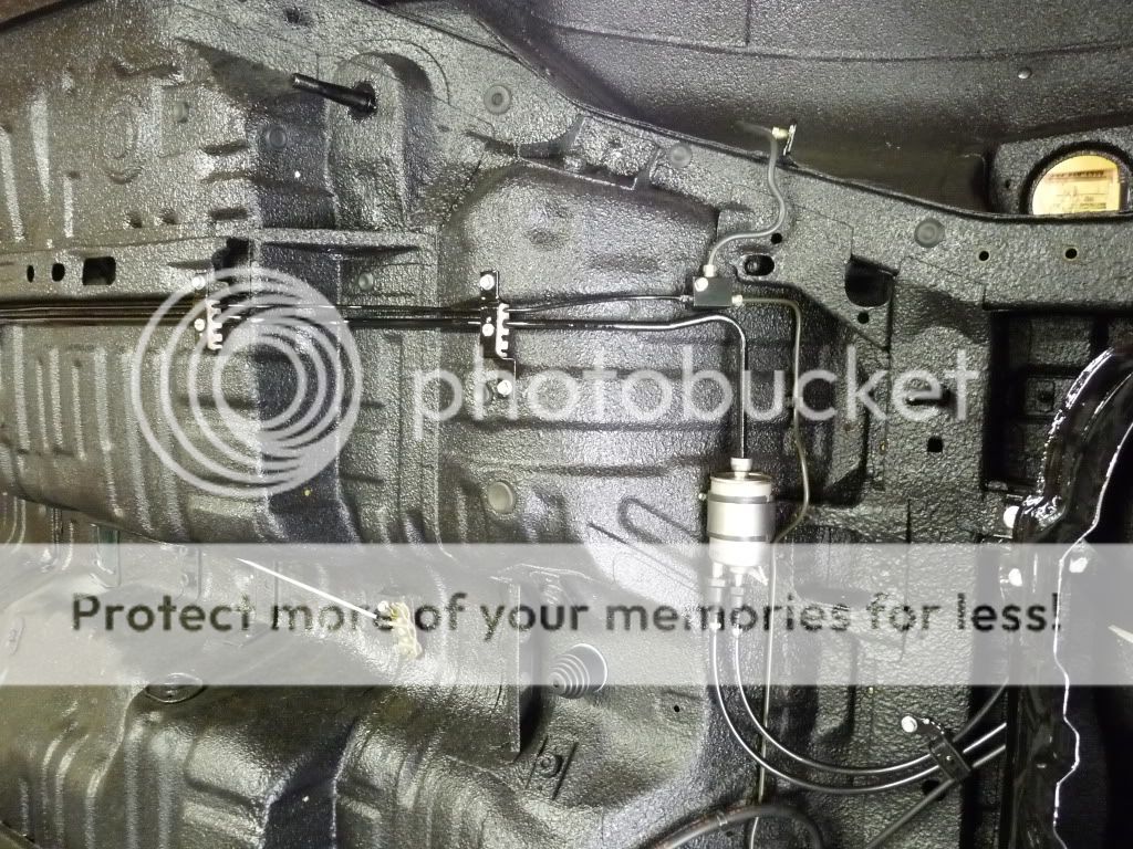

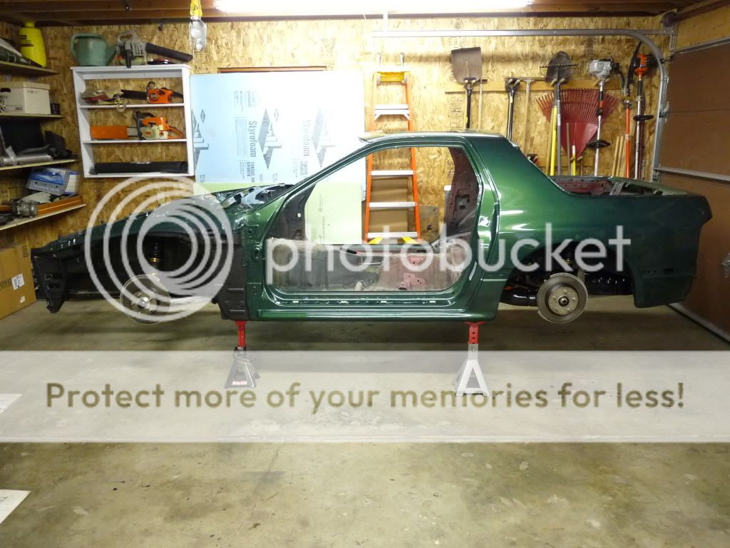

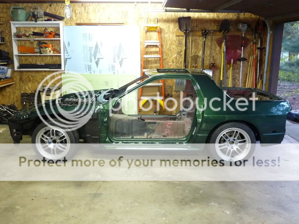

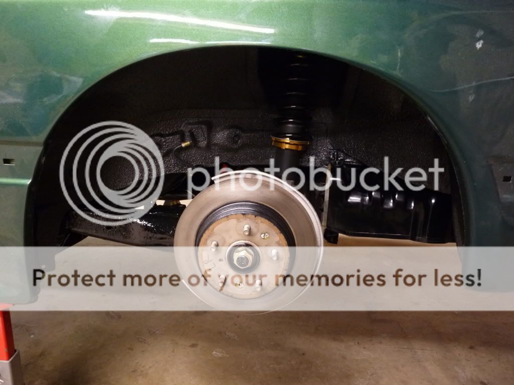

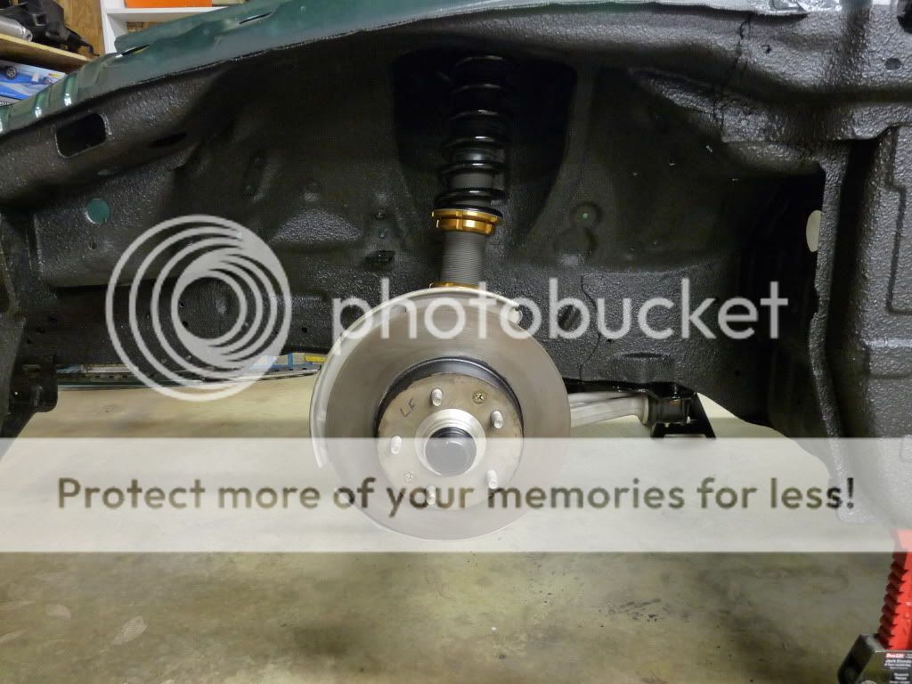

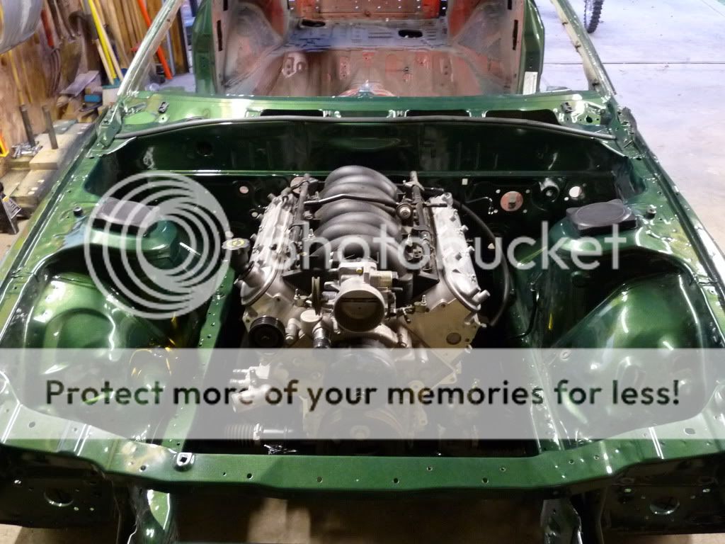

Update!
I got the brake and fuel lines painted and mounted.
I finally took it off the rotisserie, and got the suspension all bolted up!
I did also get the steering rack and front swaybar installed, I just didn't take any pictures...
Wheels and tires on, and the engine and tranny in. We're making some progress now. :) I will make my final ride height adjustments later.
I need to go back and paint/undercoat where the rotisserie was bolted up.
