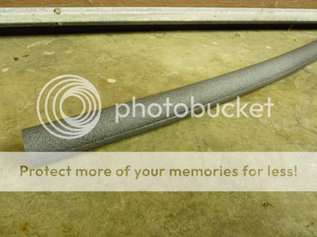

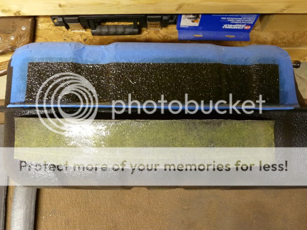

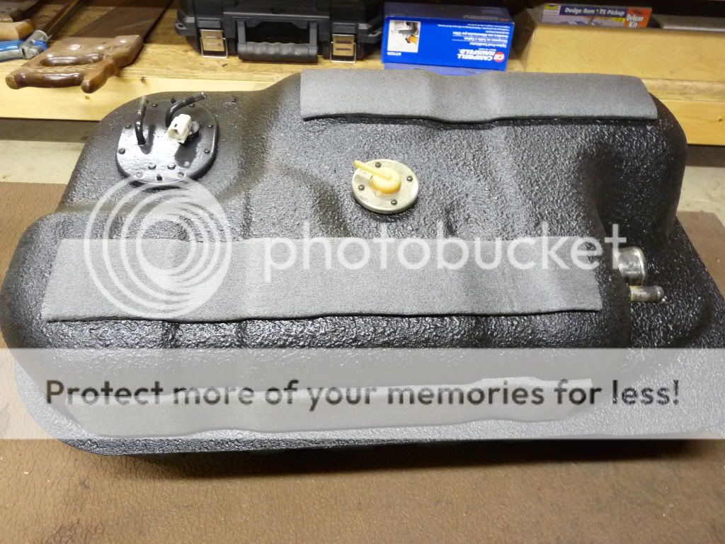

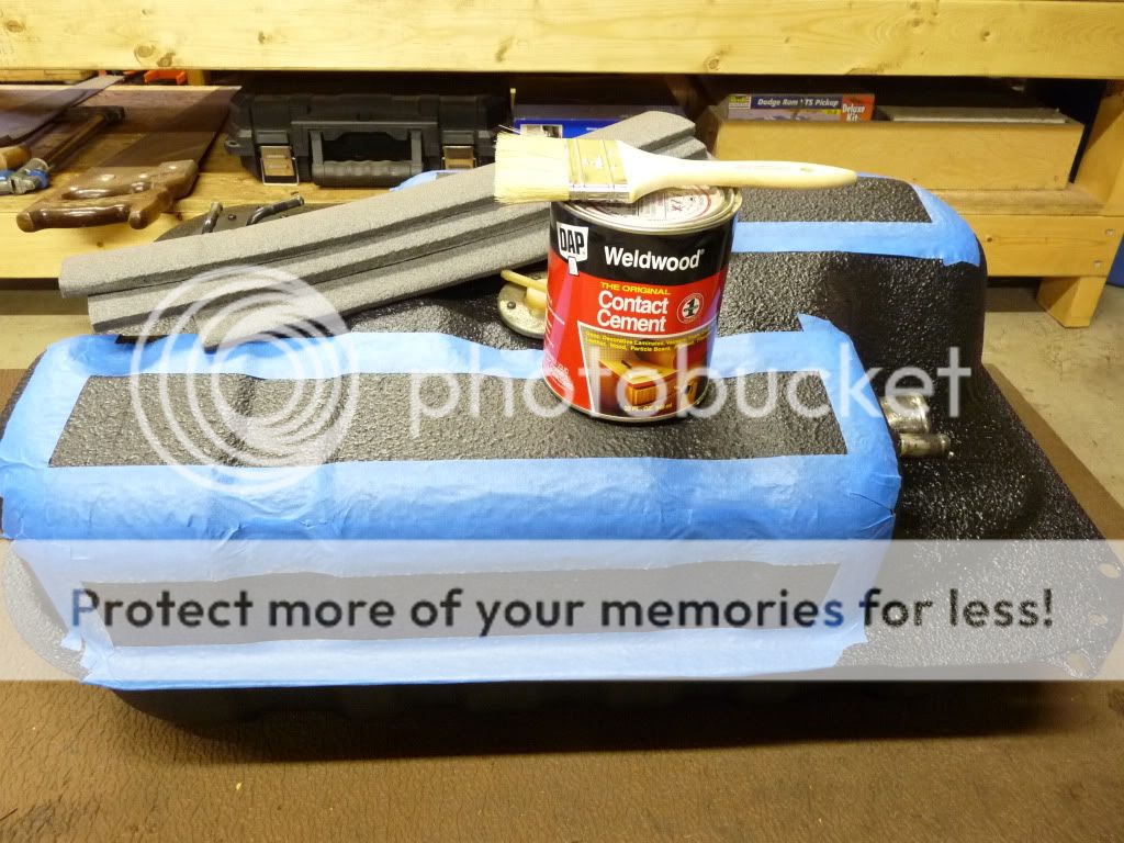

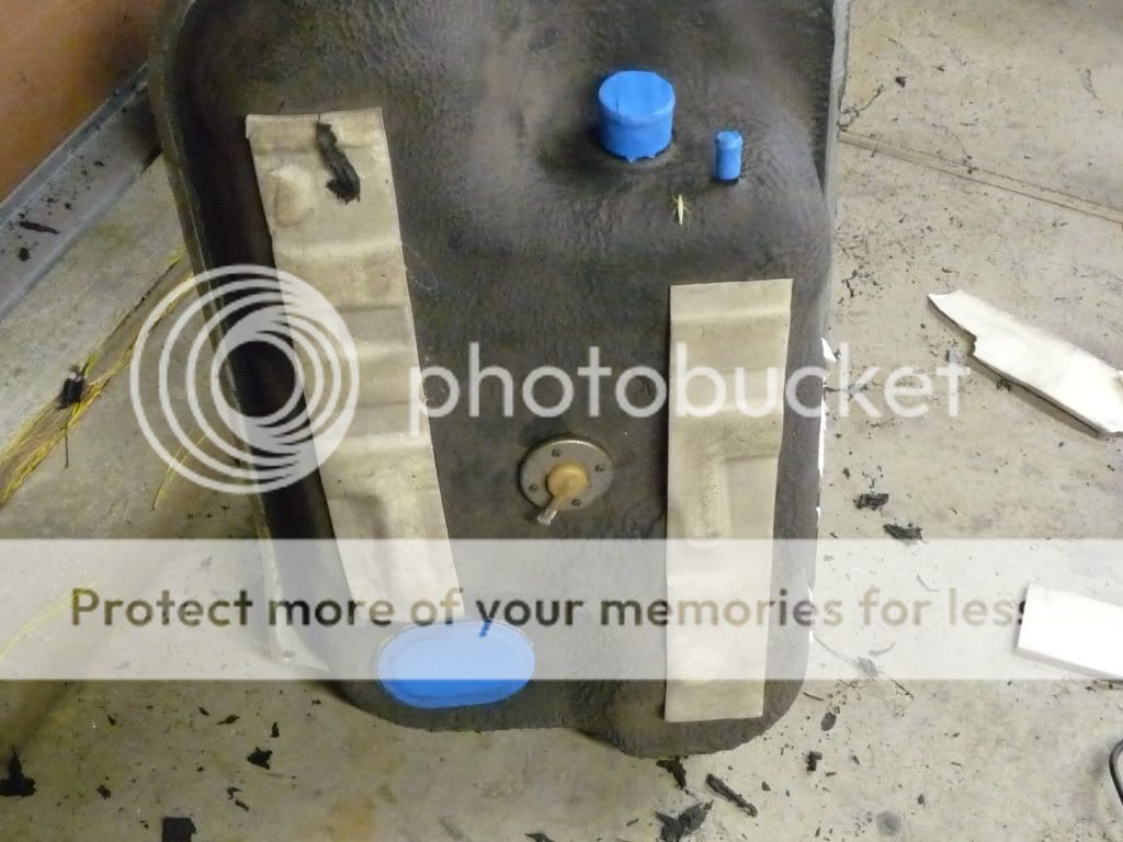

Ok, so, the stock tank had white foam padding on top and the side. I ruined the foam trying taking it off when I was stripping the tank.
So instead of going to the dealership where they probably wouldn't have it or would be over priced, I bought some 1" copper pipe installation, flattened it out, cut off the excess along the edges, and cut to size.
I then masked off the areas the foam would cover, roughed up the bedline coating on the tank, and glued the foam down with contact cement.
I applied the contact cement to both the foam and the tank, waited 15 minutes, and carefully laid them on (once the cement touches itself you can't pull it apart).
The finished product.

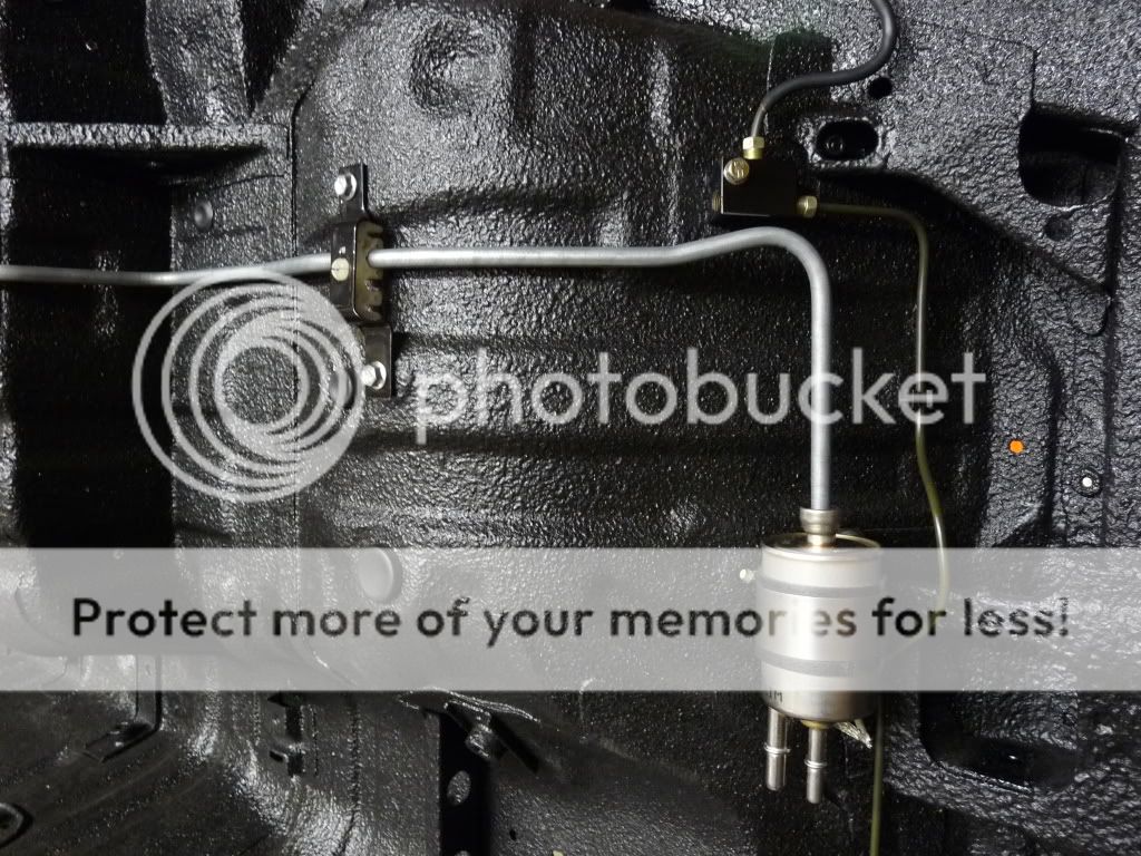

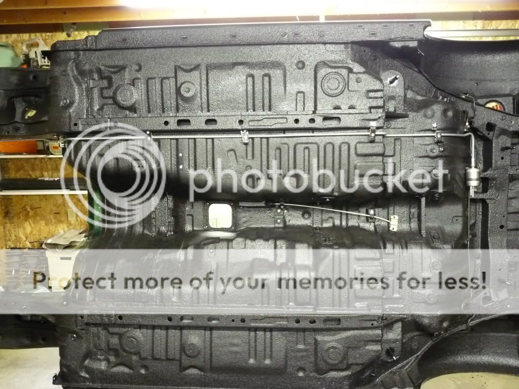

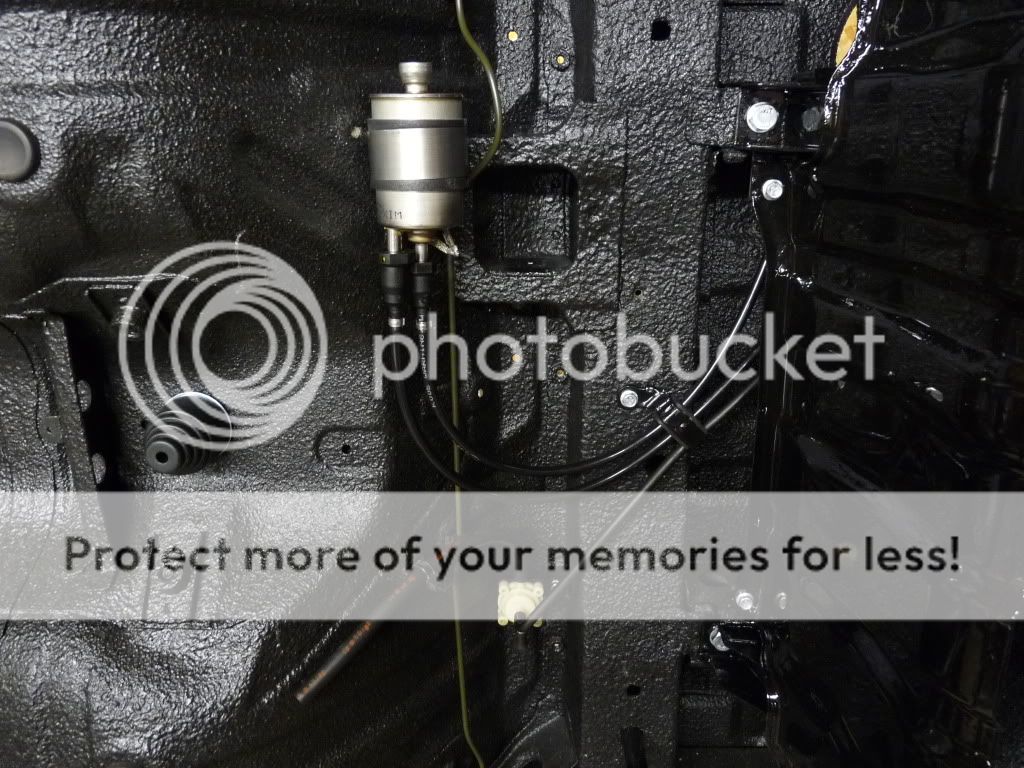

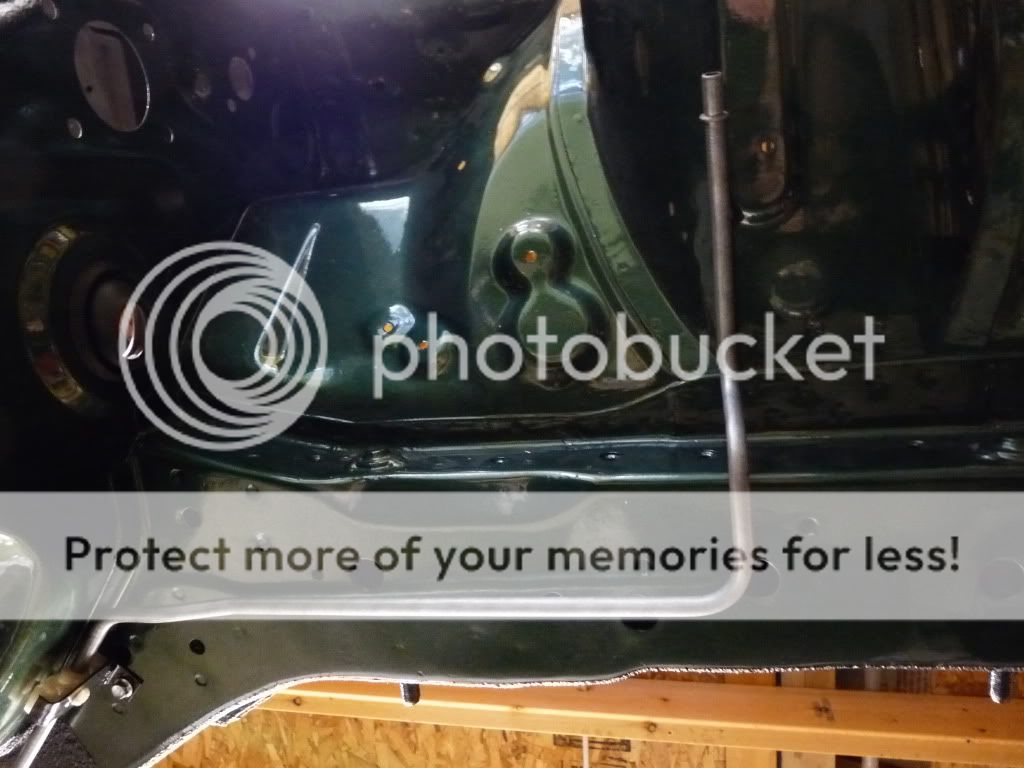

I started thinking about what I was going to do for the fuel plumbing. After some research I decided to buy a C5 corvette fuel filter/pressure regulator. I then mounted it back by the differential away from heat.

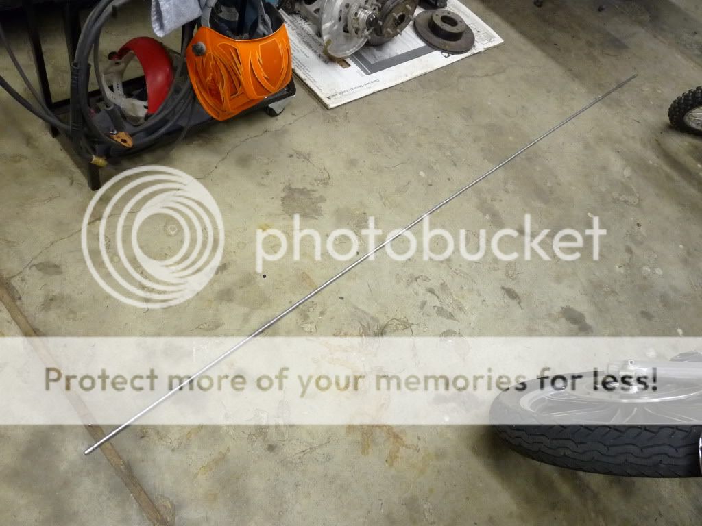

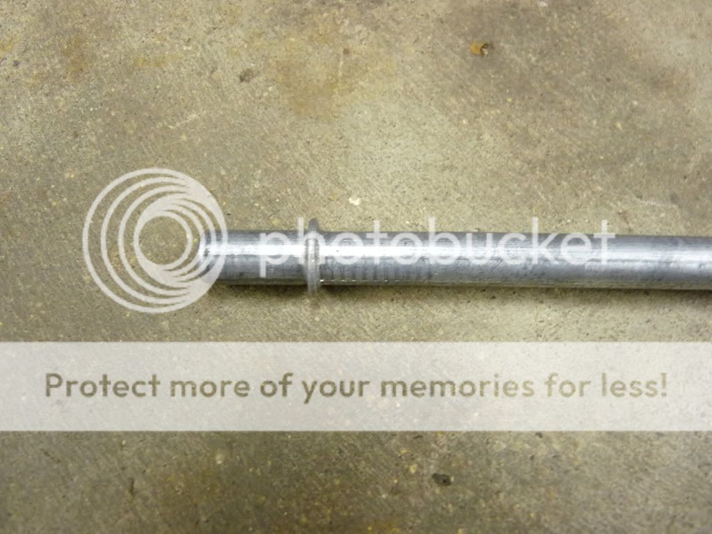

Instead of doing what most people do by adapting to the stock line, I wanted to make a whole new line. So I called up Classic Tube and had a 3/8" diameter 111" long line made with male GM fuel quick disconnect flares at each end. The line is made with their "OE" steel and was about $20 shipped, and it will be painted with a POR-15 like paint to help prevent corrosion. If you prefer stainless steel, Inline Tube can make it for about $50 shipped, but be warned, you MUST use a good quality bender to bend stainless in this diameter. Ask me how I know?
Here is a close up of the flare.

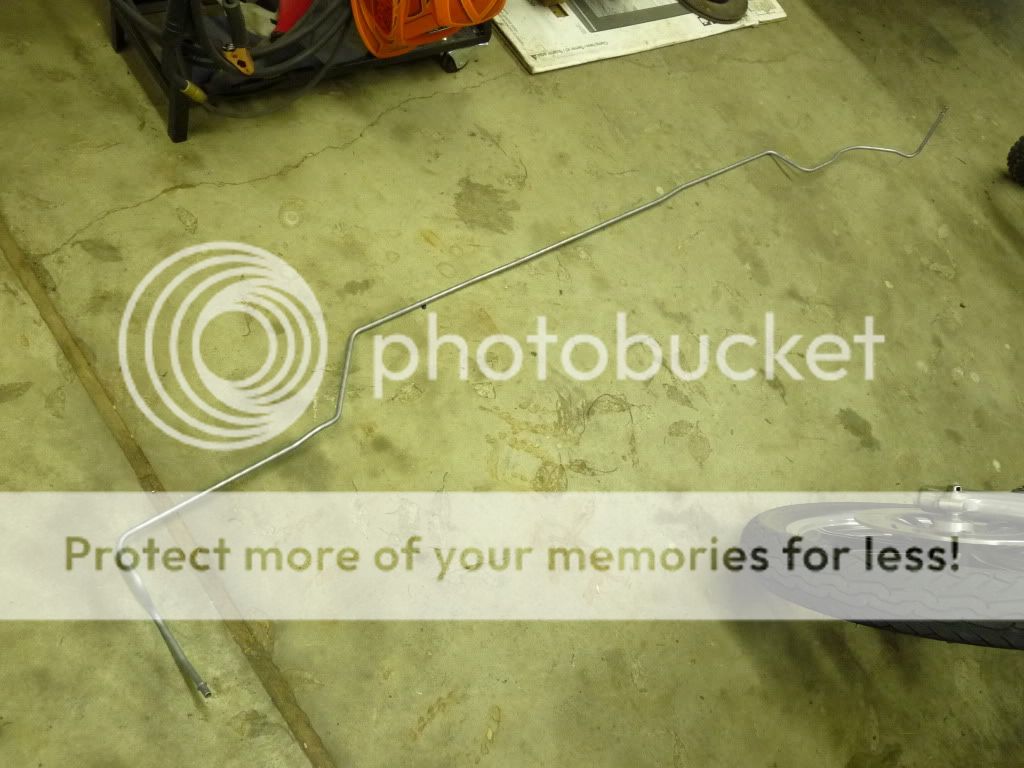

I then bent the line to fit the car.
Ended at the driver side strut tower. It's not secured in this picture, but it will be eventually.
Here's a picture of the line off the car.

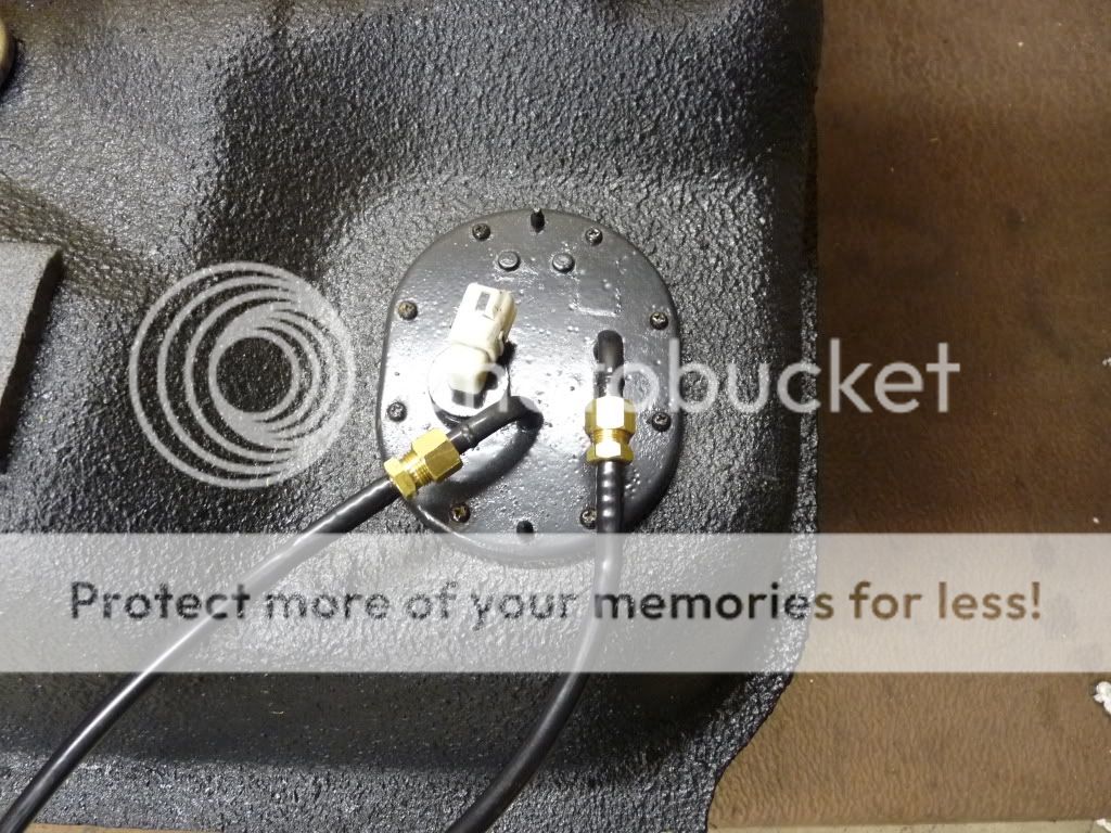

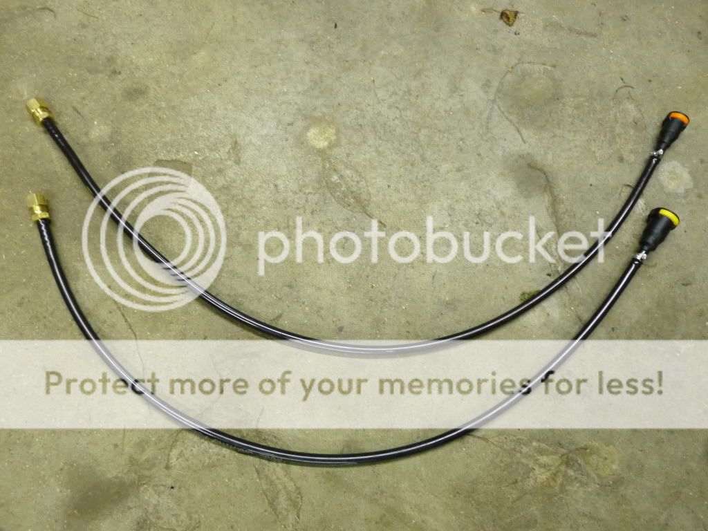

For the flex lines going from the tank to the filter, I used 5/16" to 5/16" and 5/16" to 3/8" quick disconnect fittings at one end, and 5/16" compression to 5/16" nylon fittings at the other end, with about 2' of nylon line in-between.
I cut off the flared ends on the fuel pump, slipped the compression fittings over, and tightened them.

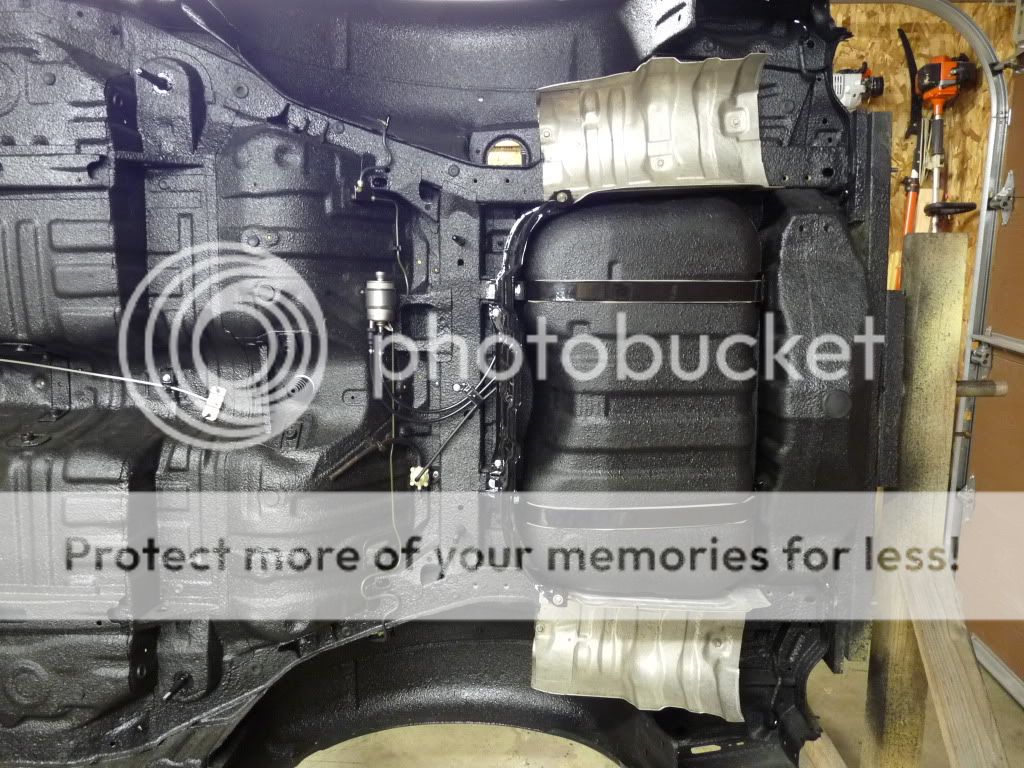

I got the fuel tank and exhaust heat shields put back on.

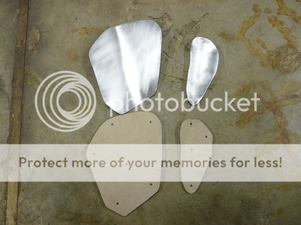

I wanted to make some heat shields for where I clearance the firewall for the headers.
So I made some templates out of cardboard and cut them out of aluminum.
All mounted up.
