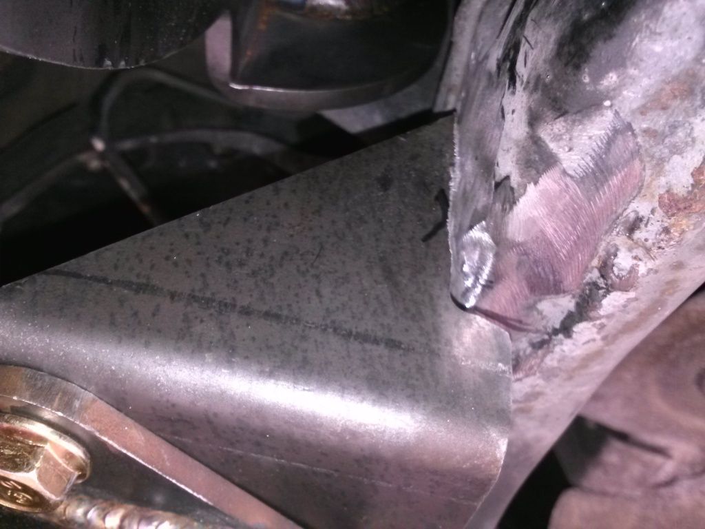

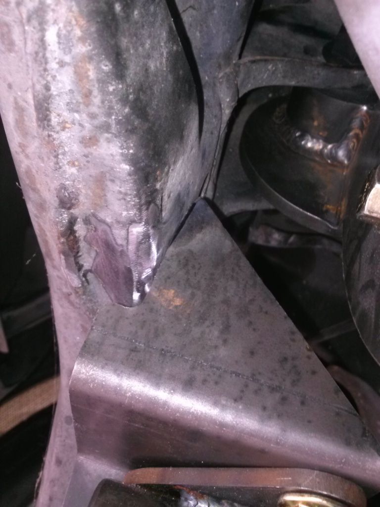

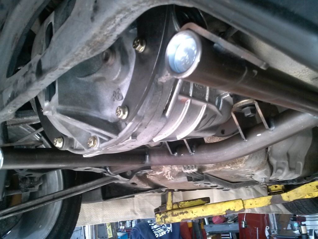

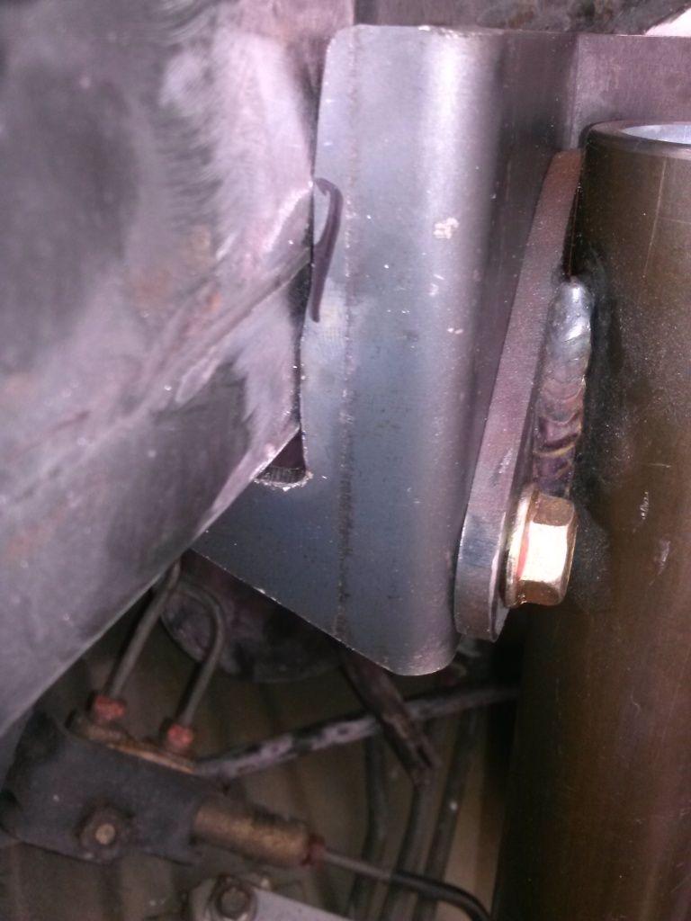

yesterday, i oficially started working on the fd
bolting the cobra diff to weld the metal parts that come in the samberg kit
making sure everything sit the way is supposed to before welding it

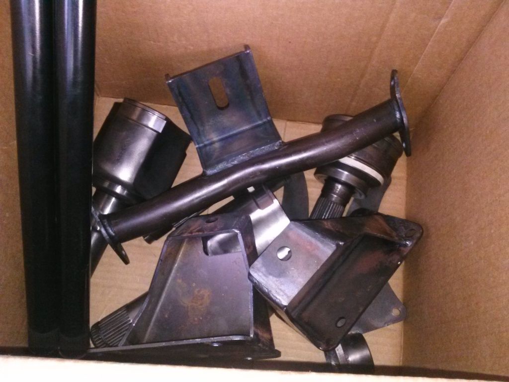

taking subframe of to be drop off at the powder coater

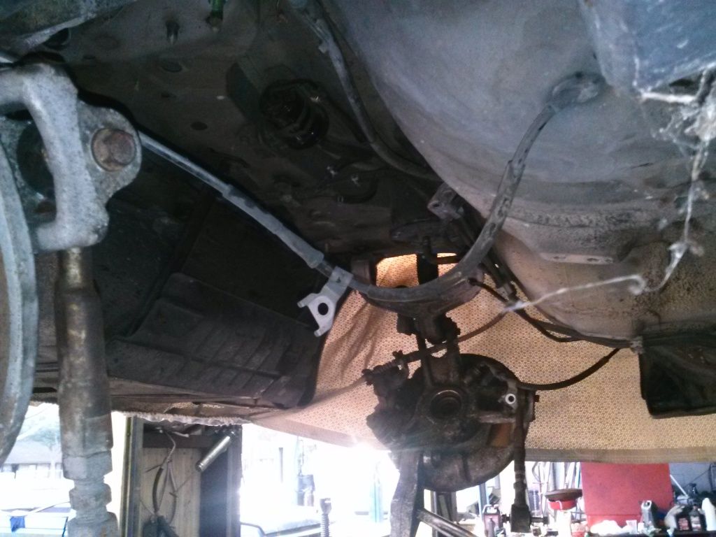

parts ready to drop off at the coater plus the subframes
gonna be removing everything from underneath the car to pressure wash it to do a bedliner coat on it
