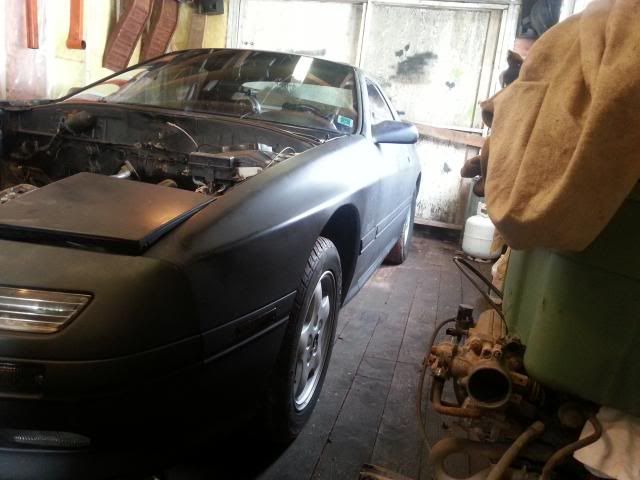

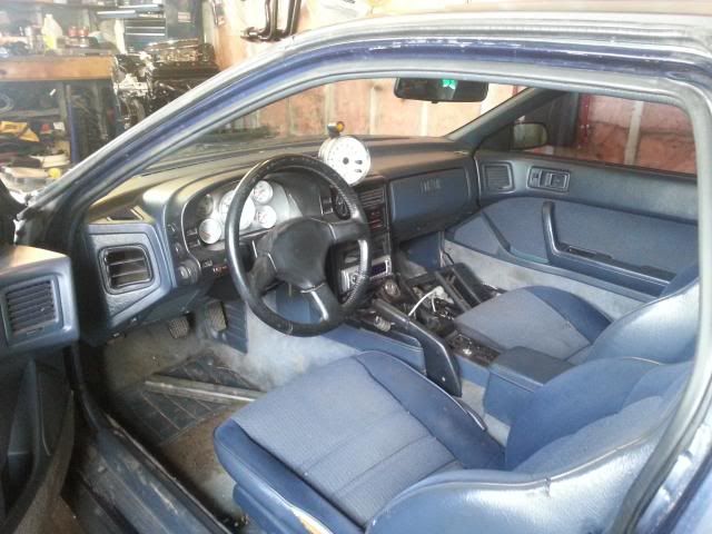

here are some pics of what i started with
custom guage cluster by previous owner.
a homemade scoop i am going to mold onto the factory hood at somepoint.

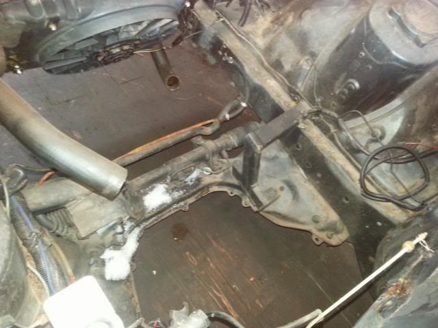

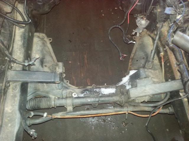

does anyone recognize these engine mounts i believe they are a old kit from someone.

« Reply #3 on: November 06, 2013, 04:47:18 PM »
those engine mounts are no kit i have ever seen before.  probably custom.
:bacon:
Offline rex388
  • Location: Winnipeg, Manitoba, Canada
  • Posts: 762
Re: Atlantic canada 91 rx7 build (old school sbc)
« Reply #4 on: November 06, 2013, 05:33:58 PM »
Those are the closest thing to engine plate as you can get without getting one.

they are pretty rugged mounts for sure, but they do the trick. may change them down the road if i decide to go with more power.
